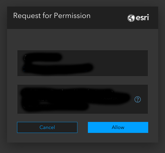

I get redirected to a window that asks if I want to allow that connection
How can I bypass this Windows?  I'm using ArcGIS Code 4.29.7.
