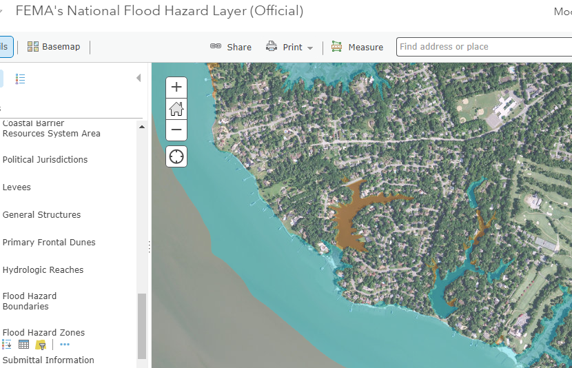

OK it seems to be working sort of...missing all the blue area in the water...
Are you seeing the blue in your app?
My App
FEMA's App
