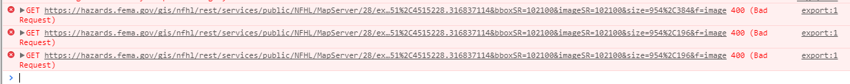

I do this and get this error about the GET request
var imageParameters = new ImageParameters();
ImageParameters.format = "jpeg"; //set the image type to PNG24, note default is PNG8.
var FloodZonelayer = new ArcGISDynamicMapServiceLayer("https://hazards.fema.gov/gis/nfhl/rest/services/public/NFHL/MapServer/28", {
"opacity" : 0.5,
"imageParameters" : imageParameters
legendLayers.push({ layer: FloodZonelayer, title: 'Flood Zones' });
