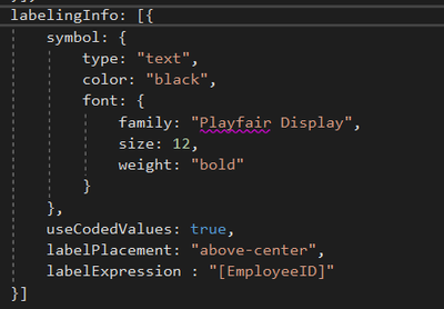

KoltWright
I don't know if you still have this issue or still need it solved, but I was able to this issue by using the labelExpression attribute and the useCodedValues to true.
