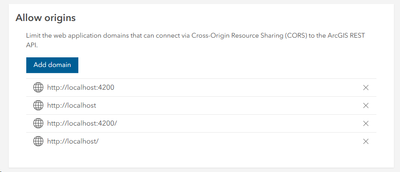

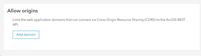

I also found this setting:
But as one can see its empty. From the description saying to "limit" means for me having no entries at all means "unlimited".
Can this cause the * in the response header claimed by the error above?
When I try to put in my domain "localhost" "localhost:4200" "http://localhost:4200" "http://localhost" that does not work, because I then am getting a general CORS error to be blocked.
Also putting our Webserver where the app is deployed (my.server.local) does not even allow this app. It also stays blocked by these settings.

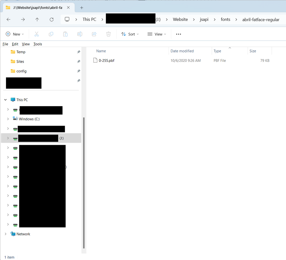

We too have had a need to host the font files locally.  The images below show our folder structure, where the "Website" folder is the root directory of our website, and then you see further subdirectories "jsapi" and "fonts".  It is this "fonts" folder in which we've organized the font files in the same manner as seen on Esri's site.
In the code, we just add the following, and it works:
esriConfig.fontsUrl = "/jsapi/fonts";
If your application is on a different server than the fonts, you'd have to use an absolute URL, e.g.:
esriConfig.fontsUrl = "https://myServer/jsapi/fonts";

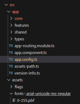

2a) local delivery
As info provided by @JoelBennett it works good and is the short workaround now.
I set
esriConfig.fontsUrl = './assets/fonts'
where assets is a direct subfolder of the ts-file (serc/app/app.config.ts) I am setting this.
This for I copied fonts from portal folder from the machine where we installed the portal under:
C:\Program Files\ArcGIS\Portal\apps\fonts
Done and working.

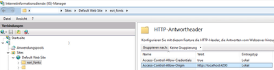

2b) Host dedicated folder on IIS
- create new folder under IIS:
C:\inetpub\wwwroot\esri_fonts
- Again copy fonts into this new folder from portal folder:
- On IIS Manager add CORS Header to HTTP-Response-Headers:
Access-Control-Allow-Credentials = true
Access-Control-Allow-Origin = http://localhost:4200
- This time setting the fontsUrl to:
esriConfig.fontsUrl = 'https://my.machine.local/esri_fonts'
Done and working.

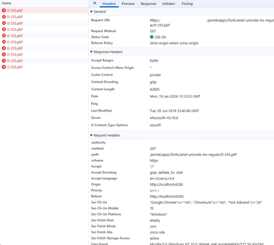

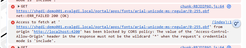

2c) Read from Portal
- At first setting the fontsUrl to:
esriConfig.fontsUrl = esriConfig.portalUrl + '/apps/fonts';
 - Now I get the following http errors:
Access to fetch at 'https://my.machine.local/portal/apps/fonts/arial-unicode-ms-regular/0-255.pbf' from origin 'http://localhost:4200' has been blocked by CORS policy: The value of the 'Access-Control-Allow-Origin' header in the response must not be the wildcard '*' when the request's credentials mode is 'include'.
As already mentioned I assume this is about the portal settings where no allowed origin is set yet and therefore * is given as header value.
On Portal/Settings/Security/Allow Origin I tried the following entries:
http://localhost
http://localhost/
http://localhost:4200/
I still get the same CORS errors as before.
I found this file:
C:\Program Files\ArcGIS\Portal\framework\webapps\rootapp\WEB-INF\urlrewrite.xml
Which contains this:
  <rule>
    <from>.*</from>
    <set type="response-header" name="Vary">Origin</set>
    <set type="response-header" name="Access-Control-Allow-Origin">*</set>
  </rule>
When commenting out and restarting the server in appears again, seems the portal repairs itself.
I am wondering why * is given here since * is not allowed any more at all as far as I know.
I am not sure whether this is the cause of my problem.
May this is a bug in the portal where pointing to the fonts folder is not supported/tested any more?

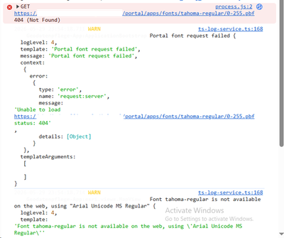

SebastianKrings
For any reason the app keeps trying to load tahoma-regular font which does not exist on server.
We cannot find any single point where we would use this font. We checked all symbology, templates, webmap.
This seems to come from maps api itself.
Everything works except these ugly error message in the console once (happily at most once) the user scrolls in the map.
Solution would be to add that font to server but better would be that the server already knows this font and is rolled out.
