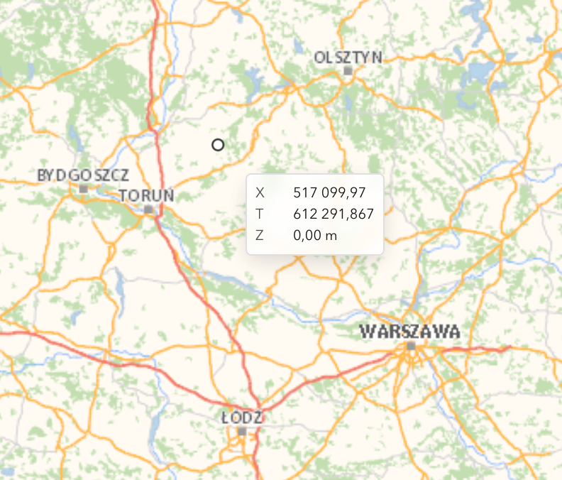

When using SketchViewModel with a local/projected coordinate system (e.g. EPSG:2180 — Projected coordinate system for Poland), the coordinate tooltip displayed while drawing shows incorrect axis labels:
- Displayed: `X: … T: …`
- Expected: `Y: … X: …`
Two issues combined:
1. The Y axis is labeled T instead of Y
2. The axis labels are reversed — for EPSG:2180 what is displayed as X should be Y and vice versa, as per the coordinate system convention
Tested on both 4.34 and 5.0 — there is no way to override this behavior.
