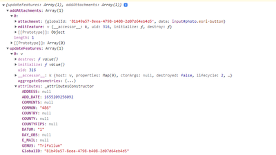

So just in testing I added the following to the featureform.on Submit (which is after the feature is created and the attributes are brought into the feature form.
const attachments = [{
              editFeature,
              attachment: {
                globalId: editFeature.attributes.GlobalID,
                data: photo
            // Setup the applyEdits parameter with updates.
            const edits = {
              updateFeatures: [editFeature],
              addAttachments: attachments
My HTML button is
 Select a file: <input type="file" class="esri-button" id="photo">
I am not exactly sure if I making any progress with this but it does show up in the console and the globalId matches
but I am receiving an error
