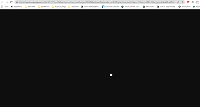

luckachi
This is what ends up being the attachment, even though a .jpg file is selected. Everything comes through as 50 B ?

luckachi
Hi @ReneRubalcava , I appreciate the help with this - I am still learning all the ins and outs of Javascript.
It is just an image that I would like to be able to upload with the record. I have been working with this code snippet but with no success, it still comes through as just a small white square with a size of 50., sometimes 25.
