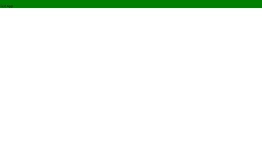

I am trying to design a relatively simple web application using ArcGIS Maps SDK components and Calcite Design System components, but am having some trouble with my page elements appearing the way I want.  I have a search component, expand component, and calcite-button component.  When the search box is populated the results appear on top of the expand component but below the calcite-button component.
I've tried all kinds of z-index shenanigans in my css, but nothing seems to get the search results on top of the calcite button.  Here is a codepen to illustrate the issue:  https://codepen.io/windowslover/pen/dPGGVKO .  I am largely a novice with CSS, maps SDK, and calcite, so any help is appreciated.  Thanks!
ReneRubalcava
Esri Frequent Contributor
For now, you want to use the `arcigs-placement` component to position custom content in the map components.
https://developers.arcgis.com/javascript/latest/references/map-components/arcgis-placement/
https://codepen.io/odoe/pen/emJJeaW?editors=1000
This will be easier to accomplish in the upcoming release, thanks!

JasonBartling1
Thanks!  That did the trick!  I was experimenting a bit with the placement component before but I guess I should have kept on with it.  I didn't think it would be necessary with the calcite components.
