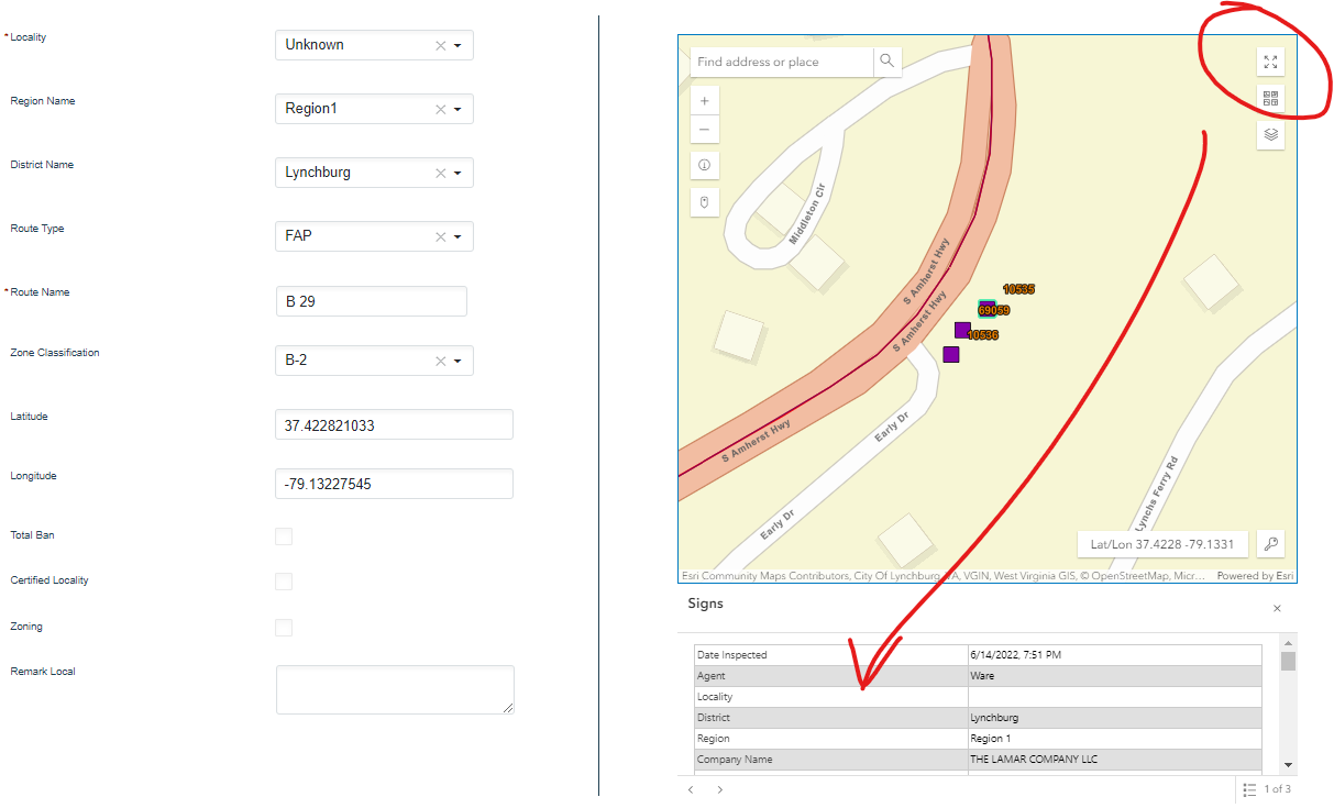

I have a .net app that I am working from that has an inset map that allows users to identify features etc.  The map is not that large so I created a new DIV and used the code below to populate the popup into this new DIV OUTSIDE the map view.  This works Great...
BUT the problem arises as I have a FULLSCREEN button in this map... When the user clicks the full screen button the map fills the screen as it should.... BUT when I click a feature the popup does not show because I am full screen...
Looking for a solution...
Is there a way that I can make the map popup show again when the user is in full screen?  Some sort of alert that when the users goes to full screen the identify no longer goes to the new DIV but pops up the map?  And when its not in Fullscreen it shows up in the new DIV?
Can I track when the FULLSCREEN button is clicked and push the results to a popup in the map view and when the button is unchecked and it goes back to SMALLSCREEN that the data is pushed to the new DIV
Or some version of this?  Or maybe some other way?  Any help would be greatly appreciated.

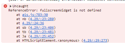

Im trying this but getting error
            // FullScreen Widget
            fullscreen = new Fullscreen({
                view: view
            view.ui.add(fullscreen, "top-right");
            reactiveUtils.on(fullscreenWidget.viewModel, "state", (value) => {
                    if (value === "active") {
                    console.log("========================Entered Fullscreen mode");
kapalczynski

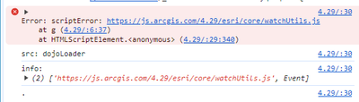

BUT I am at 4.29 and think I should be using watchUtils ????  Can I get the status of FULLSCREEN from watchUtils?
kapalczynski

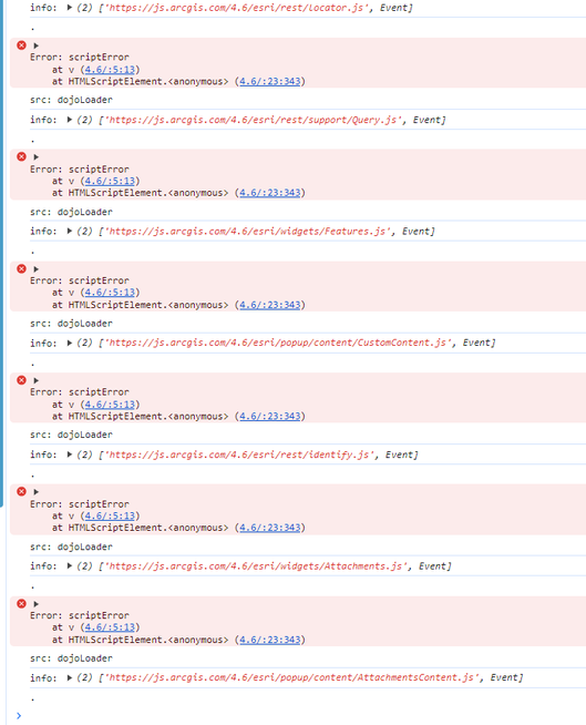

Side issue I updated my 4.29 reference to 4.6 and get all these errors... thoughts?

I think I have what I need to push the attributes to a popup and alternatively push the results to a DIV.
My issue is I need to catch when the user goes Fullscreen or visa versa...
I am using 4.29:
  • I dont see a way with reactUtils to catch the Fullscreen mode
  • If I add watchUtils to my app I get errors
    • require(["esri/core/watchUtils"], function(watchUtils) { /* code goes here */ });
  • fullscreenWidget.viewModel is 4.6 and above I think... when I set my project to 4.6 I get the errors above.. are those no longer supported in 4.6 or do I have to change them?
Any help would be most appreciated.

JeffreyThompson2
MVP Frequent Contributor
You are getting a not defined error because you named your variable fullscreen, but used fullscreenWidget in your reactiveUtils function.
You may also need to wrap the reactiveUtils function in a setTimeout function so the widget will be loaded to the ui before calling the reactiveUtils function.
