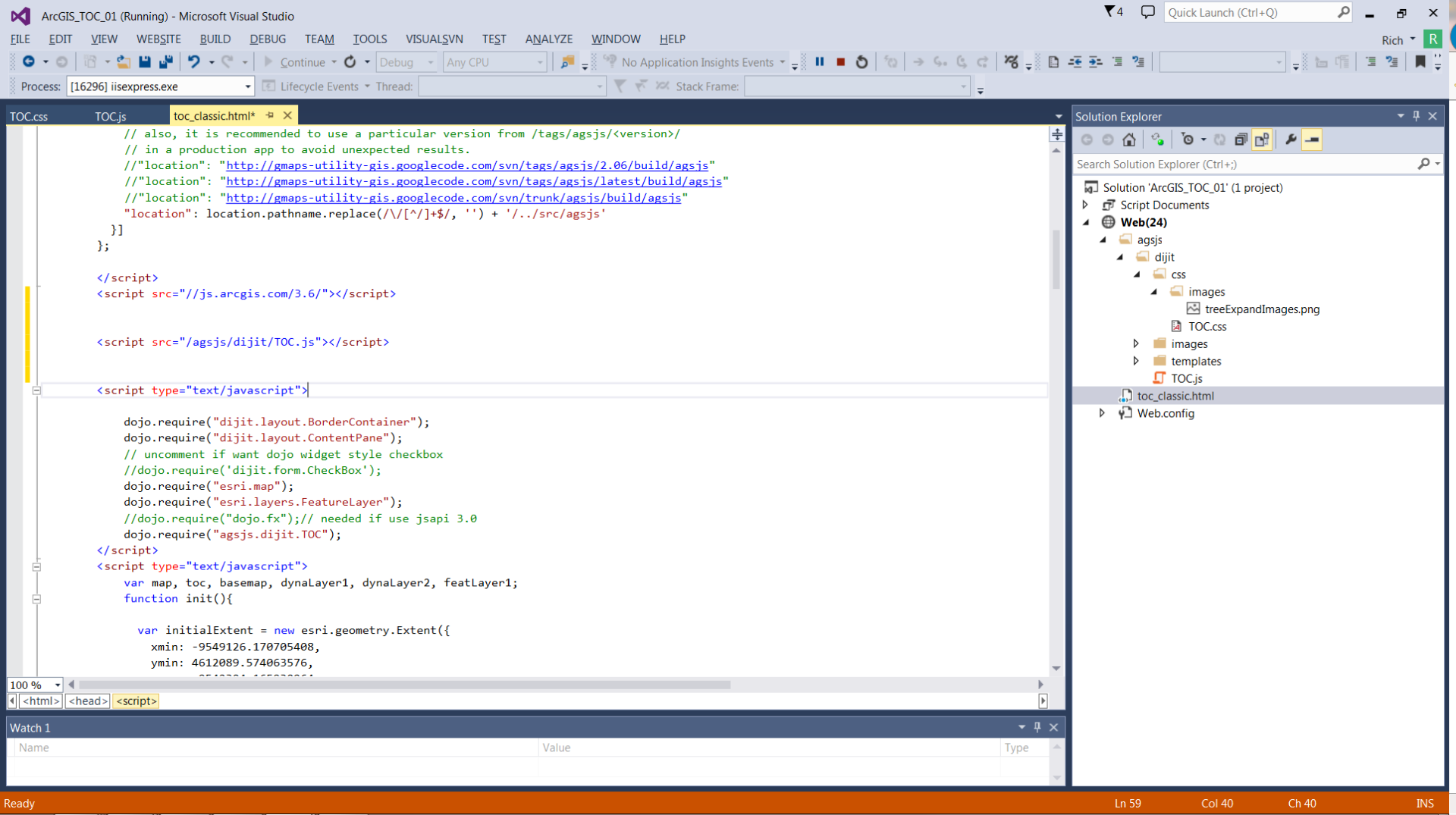

yes, I changed the code to : <link rel="stylesheet" href="agsjs/dijit/css/toc.css">
this is what my .html page looks like :
then further down, I add a reference to TOC.js :

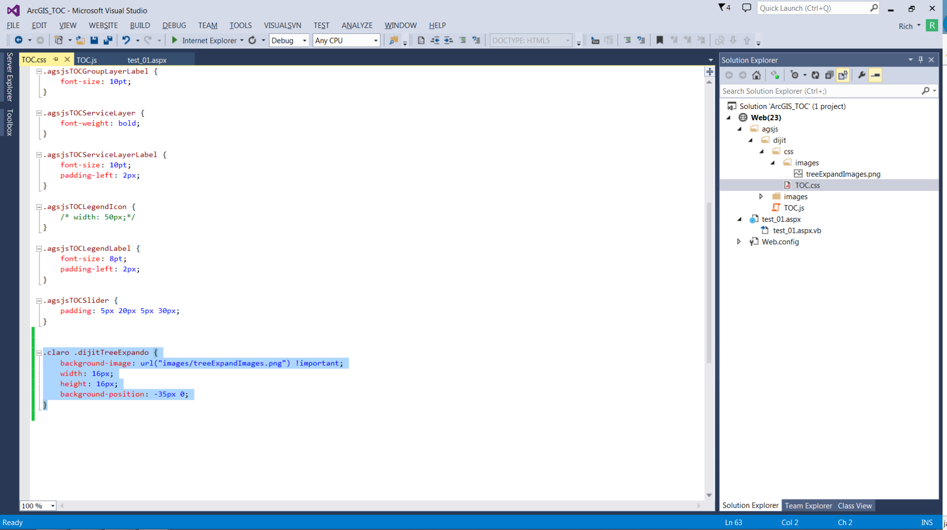

  That is pretty weird. Can you show me your TOC.css where you added the new rule?
BrianFoley1

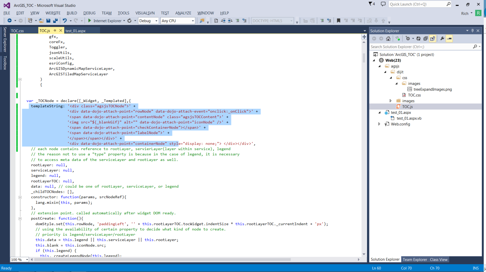

Here's TOC.css :
and here's TOC.js :

  Add this css rule right after the other you added:
.claro .dijitTreeExpandoClosed {
    background-position: 1px 0;
BrianFoley1
Robert,
