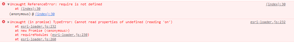

I have downloaded the npm i --save esri-loader @esri/react-arcgis but why is it i cant load the map? did i miss something?

the error i get

AndyGup
Hi@mursalahmed if you are starting a new project with React and using local builds, then we recommend using our ES modules (@arcgis/core) instead of the AMD modules that are injected using the esri-loader library. Here is an example repository: https://github.com/Esri/jsapi-resources/tree/master/esm-samples/jsapi-create-react-app.
You can learn more about the differences between the modules here: https://developers.arcgis.com/javascript/latest/tooling-intro/.
