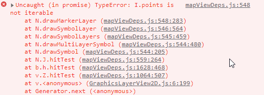

I'm trying to upgrade my app from v4.21 to v4.23 and I'm getting error below. I'm trying to debug for more details but wanted to post this in case there's a quick resolution.
I get this error when I click on a feature in a FeatureLayer. It should show the popup template, but instead this error is generated.
I noticed that this error occurs only when my features are overlapping with a graphic/geofence on a graphic layer.
I'm guessing the issue is with the MapView.hitTest improvements that now returns all features that intersect the specific screen coordinates. I'm not doing anything custom related to clicking on the feature but there must be some internal issues in my case.

Do you have a sample or codepen showing this issue to track down? The samples with popup seem to be working.
UndralBatsukh
Hi there,
Thank you reporting this issue. Our developer was able to narrow down the issue. We will get it fixed as soon as we can. We will update you once it is installed.

This issue will be fixed tomorrow in version 4.23. Can you please try it then and update us whether it fixes your issue?

There was a typings issue which we fixed. Can you please test again and let me know if you are still getting an error?

Sorry for late response. This now works for me, thank you.
