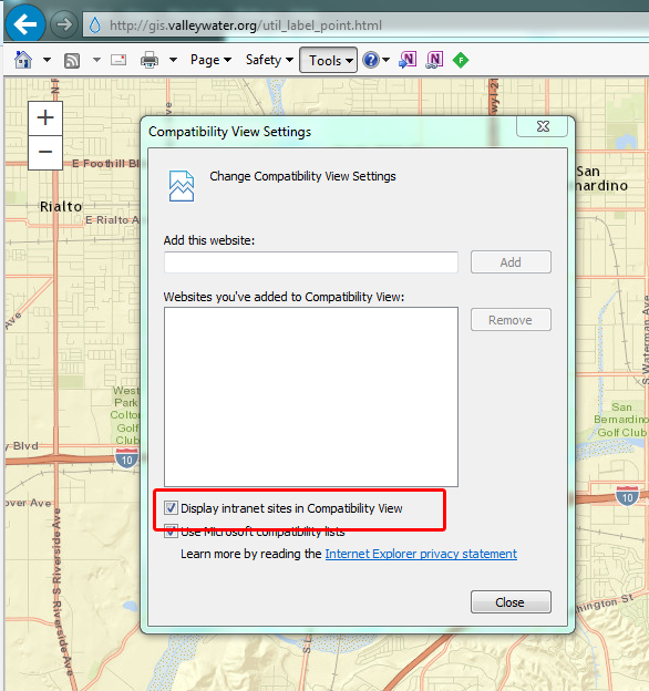

   You are exactly right. You can tell from the zoom in/out (being square and not rounded) that the page is running in compatibility mode.
Kirstin,
You need to check your IE "Compatibility View Settings" and make sure you uncheck "Display intranet sites in Compatibility View"

Even with the "Display intranet sites in Compatibility View" unchecked, my zoom +/- buttons are still not rounded...

   Is your website url listed in the Compatibility View settings dialog like I posted earlier?
