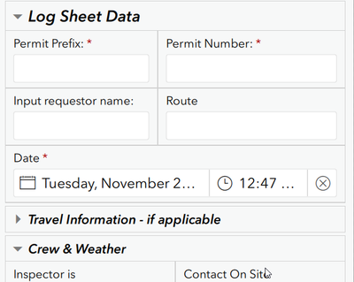

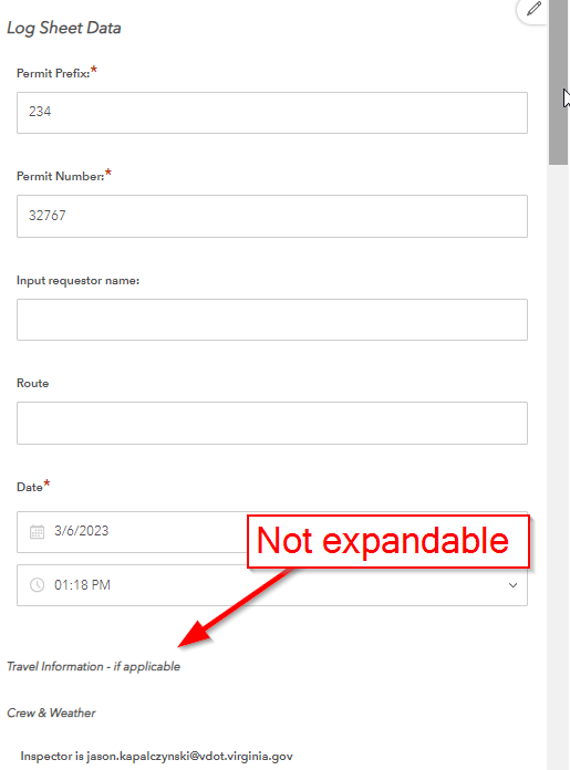

I can embed my Form onto an Iframe BUT the Format is not recognized and the collapsed sections are not active to make them un-collapsed...
Is this a bug or is there something I can do to make inherit the forms functionality of columns and collapsible sections????

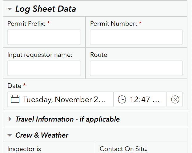

It looks like you're using a grid style? The web version of S123 won't display grids properly. Try republishing the form with a different style and see if that fixes it, maybe.

what about the collapsible sections... these will not work either? or maybe those arent working as well due to the grids?

The grid style is meant for mobile devices, so there must be some Survey123 app-related setting that simply doesn't work in a browser context.
