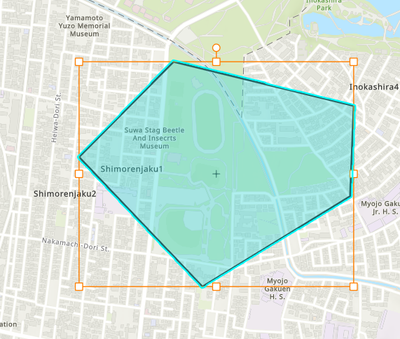

Hi,
I create polygon with the SketchViewModel and when I select the polygon, the fill color selection is "very light blue", I would like that be "transparent"
is it possible ? what the best way ? (sketch._internalGraphicsLayer.graphics.map ?)
Thanks a lot

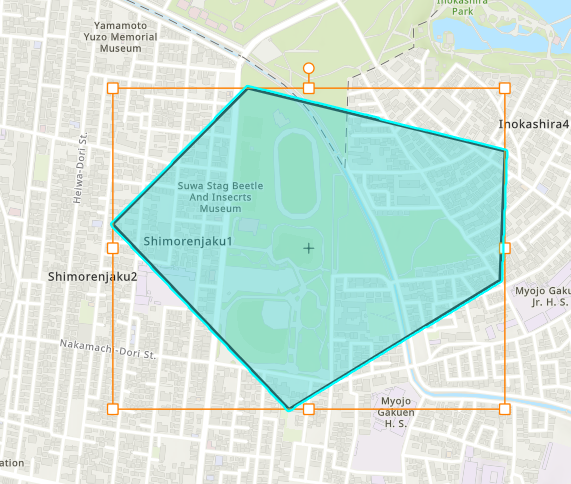

Hi @LionelGOUBET ,
Set the view's or the layer view's  highlightOptions
const view = new MapView({
  container: "viewDiv",
  highlightOptions: {
    fillOpacity: 0
https://codepen.io/sagewall/pen/abezexx

thanks great Sage
