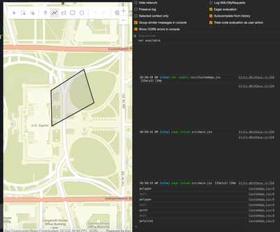

FlockSafety
Hey Andy, I was thinking it may be something in line with our build tooling locally vs when deployed. I'm not aware of any differences since they both use the same build scripts via craco.
I copied over the section of relevant code to the sample repo in Stackblitz that you linked. After getting it ported over, I noticed 2 things:
https://stackblitz.com/edit/github-mj3nqv?file=src%2FCustomApp.jsx,src%2Fmain.jsx,src%2FApp.jsx
  1. The originally posted error does not occur. This is actually consistent with my experience locally, as I only experienced the issue when the code was deployed on a server.
  2. Whenever I toggle a tool, it flickers to "null" for the pointer option. I have a console.log statement in the Stackblitz that writes the current tool. This isn't a big deal, but was a side observation I had while working on this prior to making this post
This is my first time using Stackblitz, so let me know if you have trouble viewing the posted code and I'll update it accordingly.
