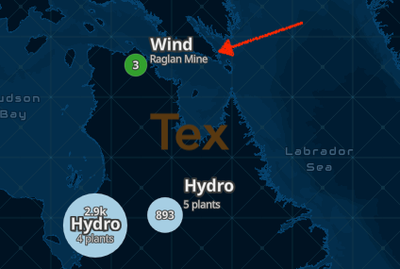

See the image below:
The green point indicated by the red arrow is an individual power plant. It is not labeled with a "1", but rather with the information for the plant itself in the layer.lablingInfo property (since it is not a cluster). The other blue symbols are clusters of 4 and 5 power plants respectively. Those labels are defined on the layer.featureReduction.labelingInfo property. Notice the label placement is different. That is because each label comes from a different label class, which is defined based on the average size of power plant in the cluster.
Hopefully that helps.
