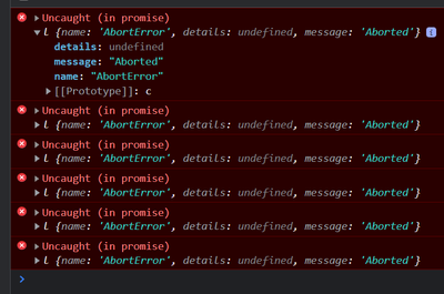

Lake_Country_GIS
Thanks. That looks like a good approach...
Seems it zooms to the first feature, then errors out though:
Not sure why. Will debug a bit.
Cheers.
