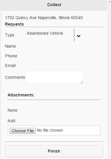

How do you get the attachments to show in the InfoWindow for this example? I can see them when you create a point, but when you identify the point it is not there.
https://developers.arcgis.com/javascript/jssamples/mobile_citizenrequest.html
If the code is modified on line 693 to  "showAttachments": true, then the window when collecting a point looks like this:
I would like the Attachments to show up in the identify window as well.

That code does not specify whether or not attachments are visible. I want to be able to see the attachment manager in that window.
