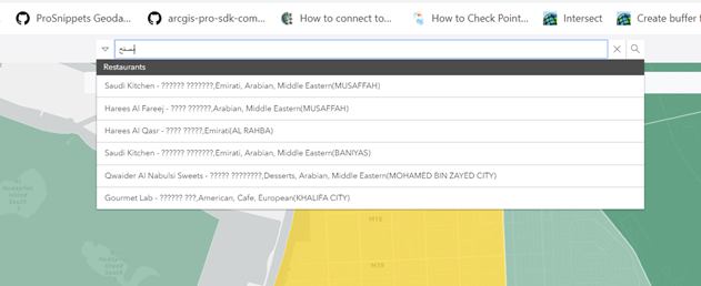

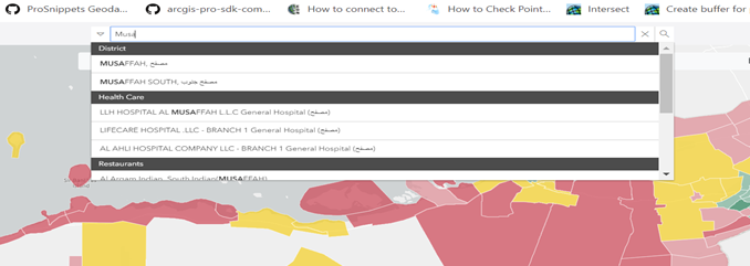

I am using ArcGIS JavaScript API 4.10. I have implemented the search widget in my application. I am able to search feature using English words but when I am trying to search using Arabic word, I got 'No results found' in suggestion Template. I have set below two properties for Search Widget
searchFields: ["NAMEENGLISH", "NAMEARABIC"],
suggestionTemplate: "{NAMEENGLISH}, {NAMEARABIC}",
 1. Search using English Characters(Musaffah)
2. Search using Arabic Characters(مصفح)
I am not getting suggestion for the Arabic Case. Any help here.
