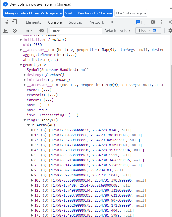

 Can the geometry of Z values ​​be returned when querying?
let btn = sceneView.on('click', (event) => {
             sceneView.hitTest(event).then((response) => {
                    if (response.results.length > 0) {
                        let graphic = response.results[0].graphic;
                        graphic.layer.queryFeatures(
                                objectIds: [graphic.attributes[graphic.layer.objectIdField]],
                                outFields: "*",
                                returnGeometry: true,
                                returnZ: true,
                                multipatchOption: "xyFootprint"
                        ).then((result) => {
                          // Can the geometry of Z values ​​be returned when querying?
consoleconsole

Hi @Wade
Yes this should be possible, but from the screenshot it seem like your features don't have any z-values stored. Or maybe the features are draped on the ground? In this case you could maybe query the height of the elevation service instead, like in this sample.
Either way it would be helpful if you could provide us with a working codepen example so we can find out what the issue is in this case.
Best, Daniel
Wade
Hi @Anonymous User
Thanks, there may be other reasons, I found the possible reason, it should be the reason for publishing the service, 3d to multipatch.
Our current production function is underground.
