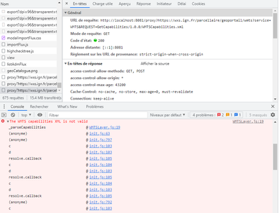

Hi,
As part of a GIS web application, using the ArcGIS API for JavaScript version 3.19, I would like to add a WMTS Layer.
For this, I copied the code provided by the documentation : documentation. https://developers.arcgis.com/javascript/3/jssamples/layers_wmtslayer.html
url = "https://wxs.ign.fr/parcellaire/geoportail/wmts?service=WMTS&REQUEST=GetCapabilities"
var layerInfo = new esri.layers.WMTSLayerInfo({
	identifier: "PCI",
layerIndex = 1;
var options = {
	layerInfo: layerInfo
layer = new esri.layers.WMTSLayer(url, options);
this.map.addLayer(layer, layerIndex);

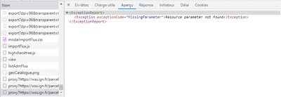

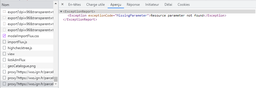

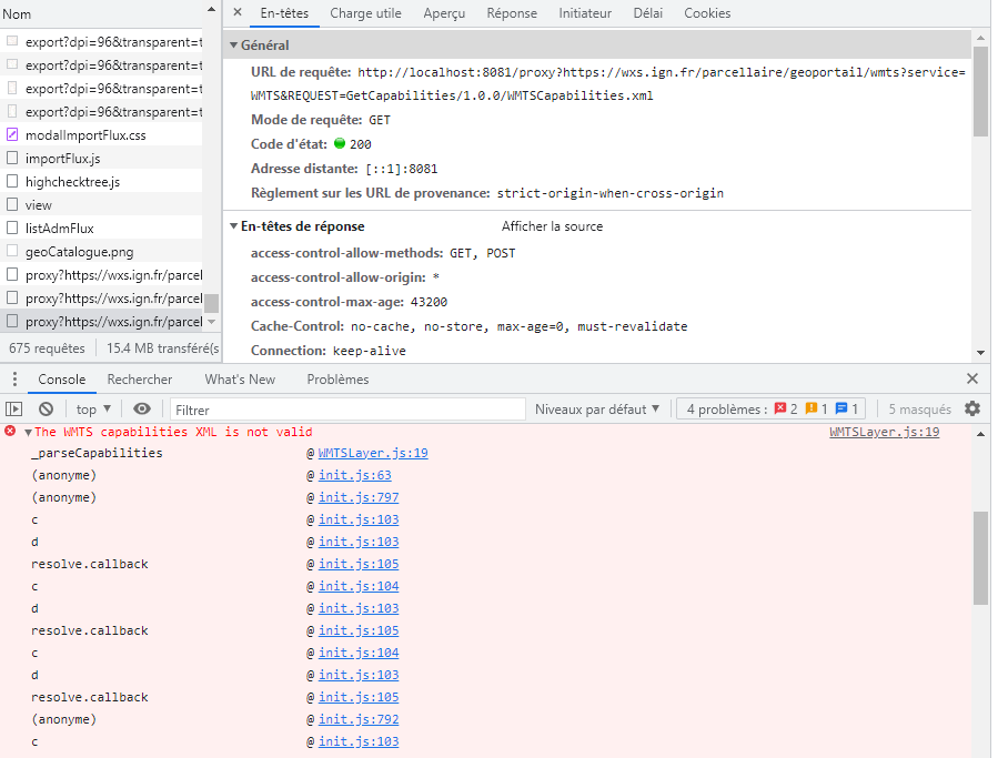

But the addition in the map does not go well. I get an error
The WMTS capabilities XML is not valid.
Looking more closely at the GetCapabilities request, I observe that in the url, the end "/1.0.0/GetCapabilities.xml" seems to be extra.
Is there a way to not have this addition, to no longer encounter this problem?

I think the first problem is that you shouldn't specify the query string in the URL as seen on line 1.
Instead, it should just be
url = "https://wxs.ign.fr/parcellaire/geoportail/wmts";
You might also consider the documentation in the constructor for the resourceInfo object.  When using WMTS layers, I've preferred specifying the necessary resourceInfo properties up front so that the GetCapabilities request can be bypassed entirely, and the application can just go immediately to rendering the tiles.  The necessary information to specify within resourceInfo can be gathered manually from the contents of the GetCapabilities response.
