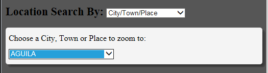

I need a sample to perform select search like this website:
Yavapai Parcel Viewer
When you select the dropdown menu, it will shows your selection option.  When you  select it then it will zoom to the location.  I didn't find any ESRI samples for it.

Hi May,
Here is a quick sample:

May Jeff,
   You are not going to find samples for everything you want to do. This is just a simple FindTask that is being executed and then zooming to the results. There are plenty of samples for that functionality.

Hi May,
Edit fiddle - JSFiddle
