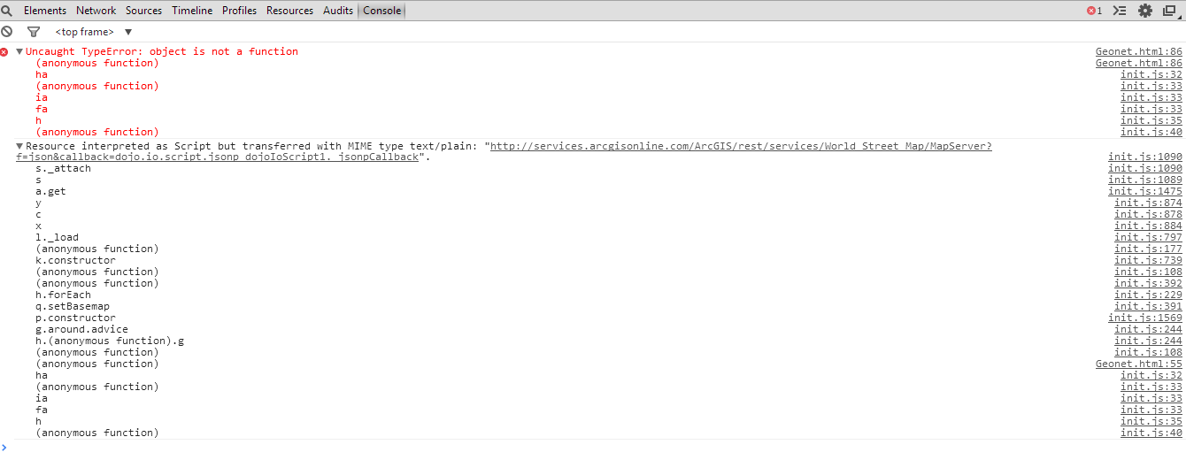

ArcGISG_I_S
Deactivated User
Dear Ken,
Thanks for your help below is a print screen of the debugger:
Thanks a lot
KenBuja
MVP Esteemed Contributor
So what's line 86 of your code?
ArcGISG_I_S
Deactivated User
Line 86 is like what you told me
on(dojo.byId("AddDTP"), "click", function mapClickHandler(evt) {
I think the function mapclickhandler is not recognize when i try to call it in updatehorizontallabel
But i dont know how to put this function outside ?
