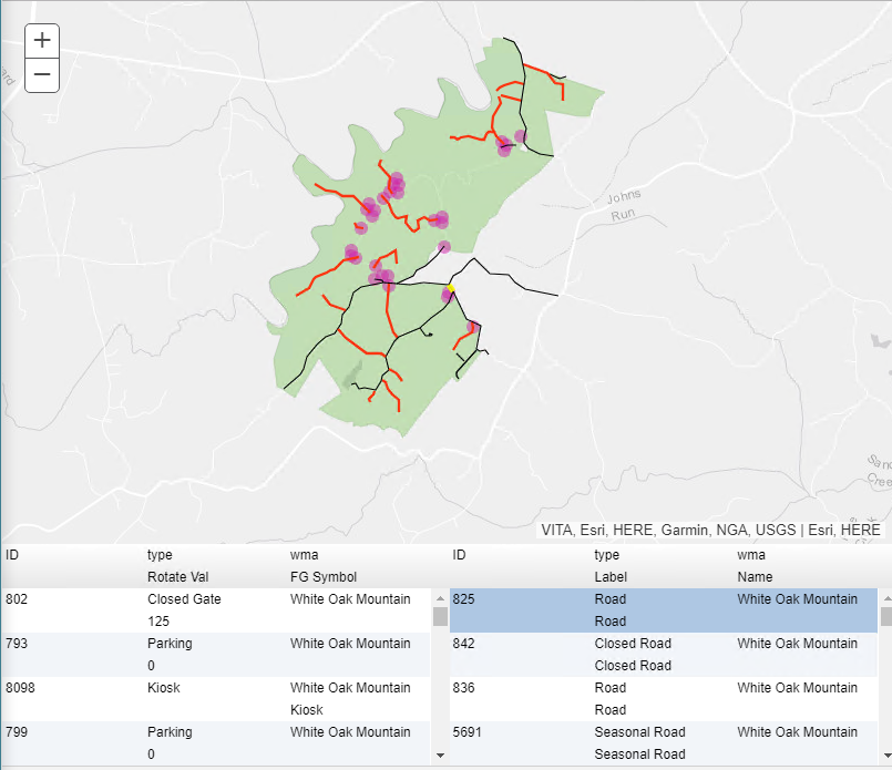

No new workflow....just changed from points geometry to a line geometry
In the image above I am querying and returning data on a Point and Line Geometry...Except the line geometry is not being show as selected.  Only the points are.
The image shows 2 grids...on the left is the Points and on the right are the lines.
I left on the roads (line layer) to shwo there is geometry.....they should be selected in purple like the points but they are not...thats my trouble.

   So the lines are getting added to the grid but not the map? This code looks off:
// Use an objectIds selection query (should not need to go to the server)
        linefl.selectFeatures(query, FeatureLayer.SELECTION_NEW, function(features2){
          var data = array.map(features, function(feature) {
You have the function returning a var of features2 then in line 3 you are using features instead.

RobertScheitlin__GISP
MVP Emeritus
Jay,
   OK, I see the issue now. the circle.contains method is expecting a point geometry not a polyline. So you have to get a point from the line to test it in the contains method.
jaykapalczynski
Honored Contributor
Im confused.
I thought there was a map click creating a point geometry.
That geometry is used to create the circle
that circle is used to select the features in the map
Both lines and points are selected and returned to their corresponding grids.
MVP Emeritus
Jay,
   No. You not following the codes workflow and understanding what it is doing. The circles extent (bounding box) is used for the initial query to the featureLayers and then the features that intersect the circles extent are tested against the Circles contains method (which expects points) to see it they are actually inside the circle and those that are are added to an objectid list to actually be selected from the FL.
