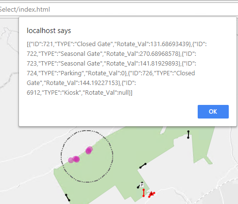

Ideas on how to modify this example to return at least one attribute from the layers into an html DIV instead of the length or Count of selected features.
ArcGIS API for JavaScript Sandbox
Preferable I would like:
1. To return attributes values for each record into an HTML Div Tag.
2. Be able to select the graphic and highlight the table record
3. Be able to click the table record and highlight the feature in the map
Anyone have a basic example of this?
Click Map, Create Buffer for selection, Return results into controlled DIV tag, Have interaction between the map and the table of results.
RobertScheitlin__GISP
MVP Emeritus
Jay,
   There is not going to be sample for everything you want to do sometimes you have to merge two samples like this then.

27 Replies
MVP Emeritus
Jay,
  This sample sounds like what you are looking for:
https://developers.arcgis.com/javascript/3/sandbox/sandbox.html?sample=fl_dgrid
jaykapalczynski
Honored Contributor
Yea thats sort of what I want....although I want to click an area, draw a buffer and then select the features within the buffer and return those results to the table.  might have to piece a few examples together...just wondering if there was a simple one layer example there already
maybe simply passing the selected features to the query fro the table?
MVP Emeritus
Jay,

Pretty puzzled...Can only get index 0 and 1 to return results....grid names same as code above, values exist in these fields...hmmmmm  But for another day.
jaykapalczynski
Honored Contributor
I am really perplexed....It appears that attributes are not being pushed into the buffer...I am definin 6 attributes and have those set in the outfields.....onyl 3 are bein pushed to the alert I set up
When  do this : alert(JSON.stringify(data));
I get this:  missing attributes...0, 2 and 4 are coming through  - 3, 5, and 6 are for some reason not coming through
Any thoughts?
          var memStore = new Memory({
             data: data
          grid.set("store", memStore);
