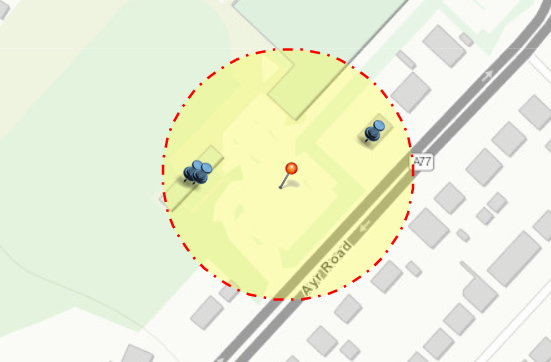

Hi, i have created some code which does the following:
1) user clicks on the map (red pin)
2) a circle is created, based on the point in step 1, and queries the feature layer for items within the radius (50 meters (?))
3) results are displayed on map (blue pins)

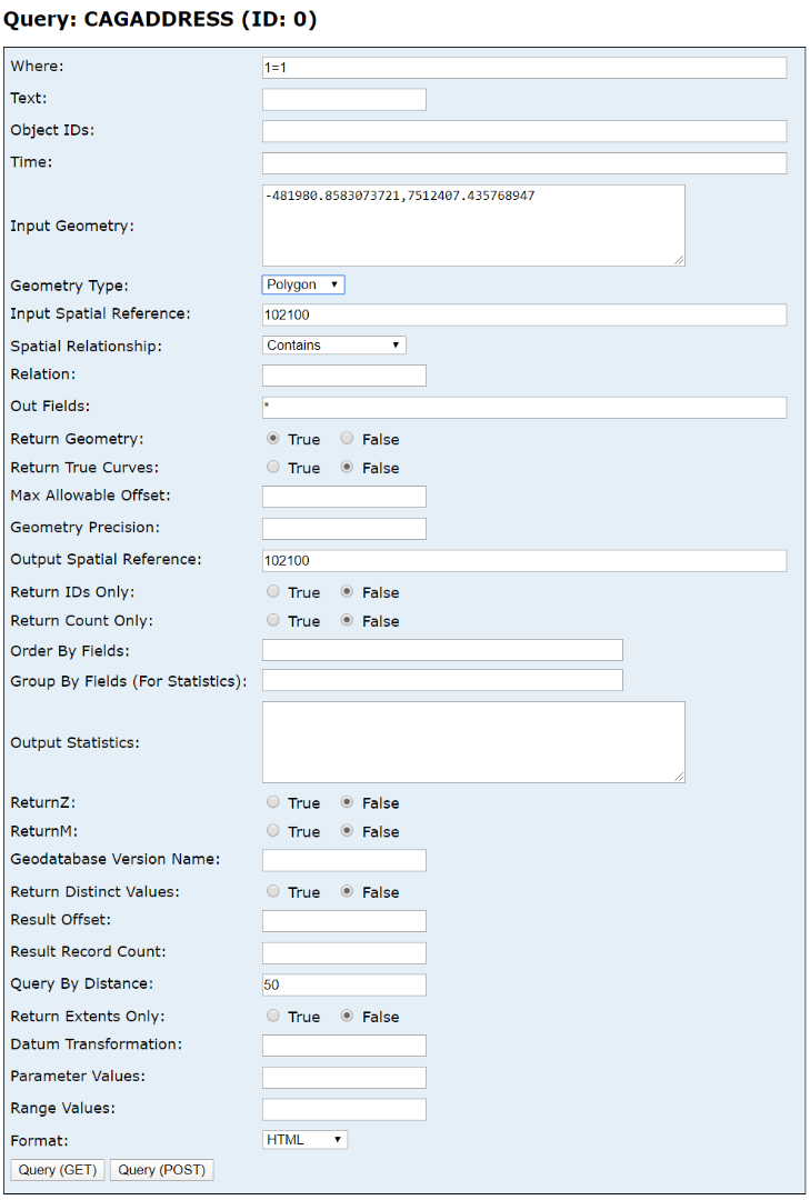

Ok, so all of the above works perfectly client side using the jsapi 3.29.
I now want to take the above functionality and replicate it in the Query Builder.  I've used Chrome developer tools to try and mimic the request, but i don't have the full picture.
Here is what i have so far.  I'm getting an error when setting the Geometry to 'esriGeometryPolygon' 'geometry' parameter is invalid (I assume esriGeometryPolygon is what i should be using as that's what i located in dev tools).  I'm also not sure how i set the circle.
Can someone help me with the combination of settings?
thanks

   OK I did some testing and is seems that a MapServer does not work using distance and a point but a FeatureServer does. So on to your second post. The geometry for the polygon should Not be encoded. and you need to click the Query (POST) instead of the Query (GET) since the query string is so long.
ScottWilson2
Hi Robert, thank you for checking this for me.
Ok, so I have managed to get it working.
1) I am using the FeatureServer instead of the MapServer
2) I am using the POST button rather than GET
3) I've entered raw geometry, no encodeding
4) The Geometry type set to Polygon
The input geometry is now returning the 3 properties contained within the boundary
