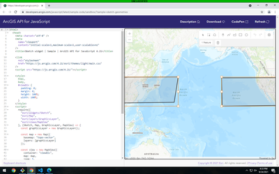

Can you please let us know if there is an ESRI recommended workaround for this issue? A vast majority of the data I work on is in the pacific ocean.

This issue has been patched and no longer reproducible in version 4.21. You can test with the following sample:
https://developers.arcgis.com/javascript/latest/sample-code/sandbox/?sample=sketch-geometries
Please let me know if you are still seeing this problem.
