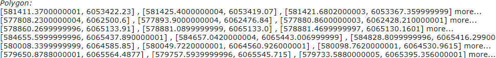

Hello,
I have polygons with multiple rings. At some zoom level I am rendering polygons to points, but only one point is rendered to multi polygons.
Is it possible to render points for each ring?

MariusPikzirnis
I have objects with multiple drawn polygons to them.  I am using a feature service. These polygons are all around the city.
If I change the renderer to simple-marker it only renders one polygon to point and that's it.
