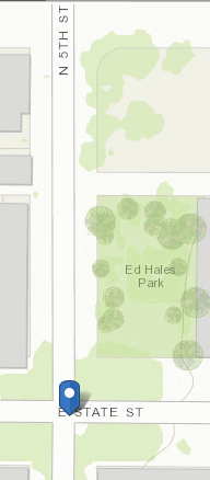

I try to use search widget to find street intersection and here are my two jsfiddle files but I am not sure why the first code with define locator is not showing up the correct intersection point.
Please try this streets:
e state st & n 5th st, redlands ca

I think its because your marker symbol has an offset set.
esri.symbol.PictureMarkerSymbol("images/mylocation5.png", 17, 32).setOffset(18, 27)
remove the setOffset and it should hit the same location.

Thanks.  It works!  How about show "Score" on popup infowindow?
