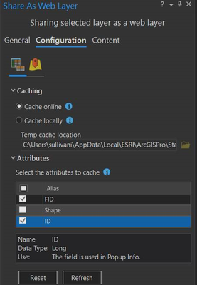

So there is something clearly wrong with the service....but I have no idea what that could be as the scene layer and associated feature layer were uploaded via ArcGIS Pro as per the screenshot.

When I upload the layers to ArcGIS Online, I have checked that the upload includes associated attributes as per the screenshot:

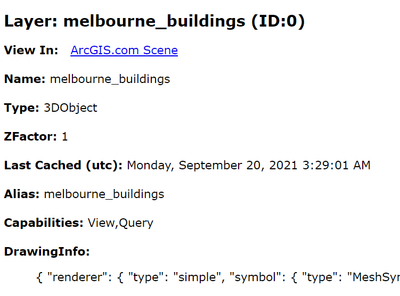

I just had a look at the scene layer metadata and I cant see any info on the fields as per the screenshot. Is this normal, or should it show info on the associated fields?
