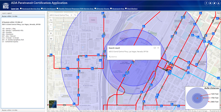

I'm taking the location returned from using the Search widget, passing that to create buffers around said point, then taking just a singular buffer and trying to simply query a featureClass for those PolyLines within the Buffer area.  So what I do is take the results of the search to grab the geometry of the point, pass that point and create multiple buffer rings, of which I only use 1 at this time and pass that distance to a locateBusRoutes function where I use the geometry of the 1/4 mile buffer to try and locate Bus Routes that are within this 1/4 mile (HERE IS WHERE I'M HAVING ISSUES), then it calls a function to populate a list of Bus Routes that fall within this area.  I'm in the process of converting this from 3.X API to 4.20 API and not as intuitive for me to figure out.  Any help with figuring out the issues I'm having with the Query would be great.  https://gisdev.rtcsnv.com/ADACert_4/  This is the application as I have it now.  I know that setting the layerView.watch("Updating") isn't the way to go as it will update numerous times and this clears out my results.  Your help is greatly appreciated.  Test with our address: 600 S Grand Central Pkwy, Las Vegas, NV, 89106, USA

IhabHassan
Hi @JohnRitsko1
I got the app working, I just updated "locateBusRoutes" function to be like this
// Locates Bus Routes within 1/4 Miles 1320 Feet
    function locateBusRoutes(geom) {
        // Acitivates the Legend Accordian Tab
        var container = dijit.byId("container");
        container.selectChild("routePane"true);
let query = busRoutes.createQuery();
        query.outFields =  ["NAME""ROUTE_NEW"];
        query.geometry = geom;
        busRoutes.queryFeatures(query)
            .then(function(response){
                console.log("Here in layerView.queryFeature");
                console.log(response);
                populateText(response);
I can see the output in the results pane.
Regards
Ihab

JohnRitsko1
Thank you so much. I knew it had to be a simple solution.  Thank you again for taking the time to get this working.  Very much appreciated.
