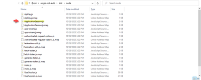

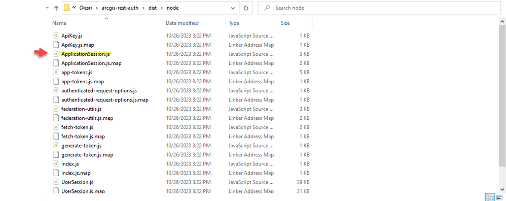

This leads me to believe there is a problem with ApplicationSession.js? I've double checked my node directory and see it exists. It is in this directory (which is in a subdirectory of my main project):
Can anyone point me in the right direction? I've been lost on this for the past few days and am not sure how to move forward from here.
