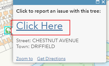

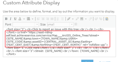

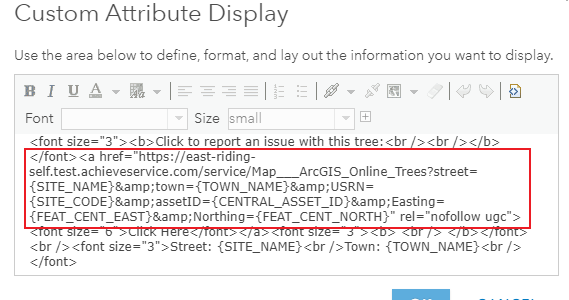

I have a Web Map in ArcGIS Online and in there I am able to add custom HTML into the popup that provides a URL link to a 3rd party system (and it also passes data via URL params). That works great as a customer clicks on the link in the popup and it passes the feature data over.

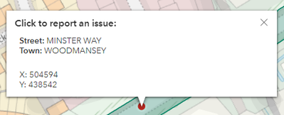

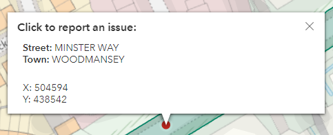

I have a ArcGIS JS map that I've developed and I'd like to put the URL link into that popup also but I can't work out how to do it. My popup in JS is customised as well so it can pick up X/Y coordinates of where a customer puts their marker (it's to report potholes on a street).

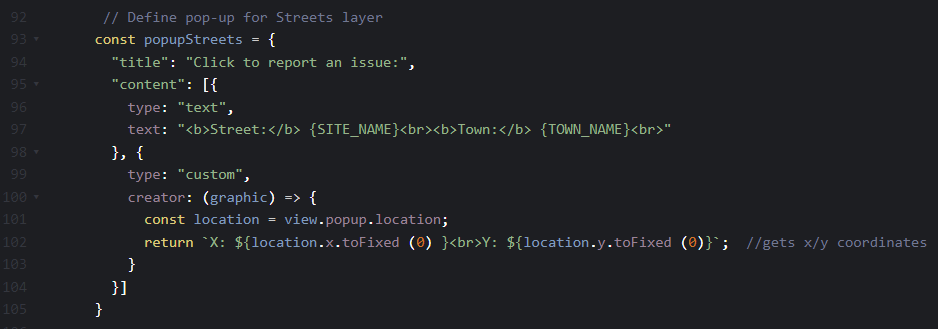

// Define pop-up for Streets layer
const popupStreets = {
"title": "Click to report an issue:",
"content": [{
type: "text",
text: "<b>Street:</b> {SITE_NAME}<br><b>Town:</b> {TOWN_NAME}<br>"
type: "custom",
creator: (graphic) => {
const location = view.popup.location;
return `X: ${location.x.toFixed (0) }<br>Y: ${location.y.toFixed (0)}`; //gets x/y coordinates
This is code from the Online popup and I'm guessing I only need the part boxed in red.
How do I get that to work in my JS code please? Thanks

I think this may be what you're looking for (may need to double-check my typing for that URL though):
	"content": [{
		type: "text",
		text: "<b>Street:</b> {SITE_NAME}<br><b>Town:</b> {TOWN_NAME}<br>" +
			"<a href=\"https://east-riding-self.test.achieveservice.com/service/Map__ArcGIS_Online_Trees" +
			"?street={SITE_NAME}&town={TOWN_NAME}&USRN={SITE_CODE}&assetID={CENTRAL_ASSET_ID}" +
			"&Easting={FEAT_CENT_EAST}&Northing={FEAT_CENT_NORTH}\" rel=\"nofollow ugc\">" +
			"<font size=\"6\">Click Here</font></a>"
		type: "custom",
The most likely issue you were having is needing to escape the quotation marks surrounding the html element attributes, since this text is already inside of a JavaScript literal.  When inside a JavaScript string, if you want a quotation mark in the string, you have to add a backslash before it, like: \"

Thank you so much both you you. Both are great solutions. After trying them both I've ultimately gone with Lauren's suggestion as it allowed me to pass the X/Y of where a user drops a pin (to report a pothole) through the URL into a form on our CRM system. It works great.
