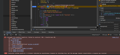

I do not have enough knowledge of the JS ecosystem to describe how this is connected. In your "ESM test" solution the problem does not occur as the resourceUrl property is populated. However, in a framework solution, that property is empty resulting in the below error.

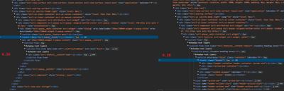

We have a project on 4.24 where the popup header is outside the shadow DOM while in 4.28 it is inside the shadow DOM.
It appears that an API to customize the popup header might be missing, similar to the API to customize the content.

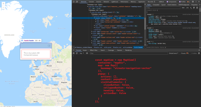

I tested this code on the next version and the popup header does not appear:
  const view = new MapView({
    map: webmap,
    container: "viewDiv",
    popup: {
      dockOptions: {
        buttonEnabled: false
      visibleElements: {
        closeButton: false,
        collapseButton: false,
        heading: false,
        actionBar: false
ViktorSafar
