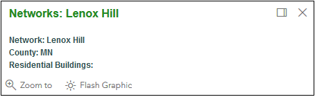

Here is the popup rendered in 4.4:
Popup 4.4
Here is the  popup rendered in 4.5:
Popup 4.5

I just came back to this problem after a few weeks of doing other things.  Now, the popup renders the graphic template without any changes to my code.
ESRI must have made some update to their API.
