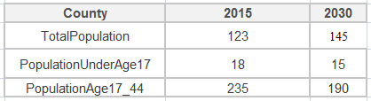

Obviously you have 2 columns for the years but how many rows are we talking? You might as well create an HTML table & use SPAN tags w/ IDs to just populate the table using element.innerHTML() once you have a map click event. & access to the data values A pain in the butt to initially code but it would work.
TracySchloss
Honored Contributor
The client isn't quite certain about the final rows, but I'd say around a dozen, tops.  I thought about making a plain table, especially since the output format is nothing like how the data will be stored in a table.  Makes it tough to have meaningful events associated with it.
I've used row Renderers before.  I wonder if I could take advantage of that to build a table.  Generally I'm making something that looks like a paragraph with divs, but I guess there's no reason why it couldn't be a table instead as long as I had the HTML format right.

HTML Table template:
<table border="1"  cellpadding="3" cellspacing="3">
  <tr>
  <td>County:</td>
  <td>2015</td>
  <td>2030</td>
  </tr>
  <tr>
  <td>Total Population:</td>
  <td><span id="lblPop2015"></span></td>
  <td><span id="lblPop2030"></span></td>
  </tr>
  <tr>
  <td>Population Under 17:</td>
  <td><span id="lblPopUnder17_2015"></span></td>
  <td><span id="lblPopUnder17_2030"</span></td>
  </tr>
  <tr>
  <td>Population 17-44:</td>
  <td><span id="lblPop17_44_2015"></span></td>
  <td><span id="lblPop17_44_2030"></span></td>
  </tr>
</table>
JS:
countyLayer.on("click", function(evt) {
    fullAttrib = evt.attributes;
    document.getElementById("lblPop2015").innerHTML = fullAttrib.TotalPopulation2015;
    document.getElementById("lblPop2030").innerHTML = fullAttrib.TotalPopulation2030;
    document.getElementById("lblPopUnder17_2015").innerHTML = fullAttrib.2015_PopulationUnderAge17;
    document.getElementById("lblPopUnder17_2030").innerHTML = fullAttrib.2030_PopulationUnderAge17;
    //etc etc etc
SteveCole
Honored Contributor
AAAARRRRGGGGHHHH. I *HATE* this stinking forum software.
My HTML got eaten up. Here's a screenshot of what it SHOULD have looked like:
