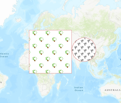

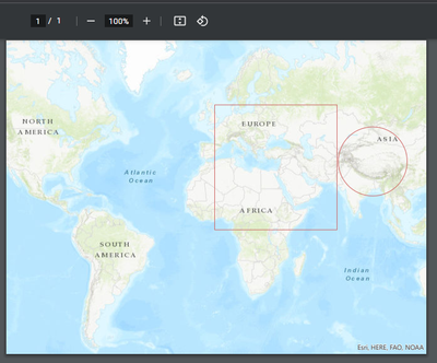

Hi,
I am trying to print polygon filled with pictureFillSymbol. The pictureFillSymbol is available on the map, but when we print it as PDF it's not available. Any idea why it's happening? I am using ArcGIS JavasScript APi  3.39
Below is the way I am using for pictureFillSymbol symbol:
https://developers.arcgis.com/javascript/3/samples/playground/main.html#/config=symbols/PictureFillS...
and PictureFillSymboll class: https://developers.arcgis.com/javascript/3/jsapi/picturefillsymbol-amd.html
Thank you for help

Hi @Noah-Sager I attached a simplefied case of my problem. I modified esri example from here: https://developers.arcgis.com/javascript/3/sandbox/sandbox.html?sample=widget_print_esri_request The circe with pictureFillSymbol apperas after click on map. Result is still the same. Picture fill not comming after print. I appreciate if you have a look and investigate this. You can copy and paste my code easly into esri sandbox.
