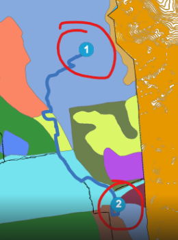

Hi ,
  I have defined a picture marker which is properly coming on the map.
stopSymbol = {
type: "picture-marker",
url: _globalGISUrl + "Images/marker/inspection-map-markers-no-status.png",
width: "22px",
height: "22px"
But when I try to take a print of the picture marker is not available in the print pdf.
ADITYAKUMAR1_0-1676649340122.pngADITYAKUMAR1_1-1676649359266.png I am working with JavaScript 4. At some discussion I saw a similar problem where it was told to check if the picture marker is accessible to the print but I am not sure how to check that.
Thanks

HI, log into the arcgis server machine and then test whether the image address is accessible from the arcgis server machine.
ADITYAKUMAR1
@Lerman Thanks for the reply. I just checked the logs of ArcGIS Server and could not find anything related to print. In case the Server is not able to access the image is there a way how to fix it.
Lerman
Hi, if the arcgis server cannot access the image, then the image cannot be printed out.
The image symbol in the screenshot looks very simple, a circle, I think you can use SimpleMarkerSymbol or CIMSymbol to symbolize the point.

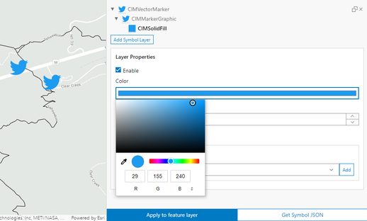

Hi Aditya,
The symbols in the screenshot can be implemented using cimsymbol, for which I wrote a demo, see:https://jsbin.com/magobotole/edit?html,output
Modify the symbol code a bit more, it will be closer to the symbol in your screenshot.

BUt I have some more picture marker and I m trying to convert them into CIM Symbol. For this I am converting the png to svg and then uploading this in the CIM builder. After that I am getting a JSON but this is bringing a black dot marker on my map. The actual color or design is not coming. Any idea where I am doing mistake?
Lerman
Hi Aditya,
I uploaded a svg file in the CIM builder site then converted to Cimsymbnol and the color was not lost. So at which step did you lose the color, png to svg?
If you can't solve the color loss problem, I think you can reassign the color in CIM builder website.
ADITYAKUMAR1
@Lerman i checked it and found there was problem with the svg file. The color were turning into black. As suggested by you I did the changes in the symbol builder and now it's workitas expected.
Thanks
