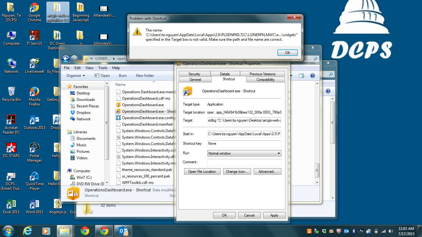

I am trying to set up the operations dashboard shortcut (Set up a development environment | Guide | ArcGIS API for JavaScript ), but when I try to change the 'Target' (using /extdbg: path name to my widgets folder), I keep coming up with this error:
The name 'C:\Users\ta.nguyen\AppData\Local\Apps\2.0\PLDDNPK0.71C\L3JNERPN.MW\p...\widgets"'
specified in the Target box is not valid. Make sure the path and file name are correct
Do you have any tips for changing the Target of the Operations Dashboard shortcut?

TA,
   There has to be a space between .exe and /extdbg:
OperationsDashboard.exe /extdbg:C:\Extensions

   What is the path of the folder you are trying to set it to (I can not make it out in the image)? When I follow the instructions and use the simple path example of "C:\Extensions" I had no problem.

I'm trying to set the path of the folder to the same folder that contains all the widgets provided when I downloaded arcgis-web-appbuilder 1.1 (since this folder will contain my custom widget eventually).
C:\Users\ta.nguyen\Desktop\arcgis-web-appbuilder-1.1\client\stemapp\widgets
I tried the C:\Extensions and I still got the same error. I'll try again. Any other ideas?

I created an Extensions folder on my C: drive and I modified the 'Target' as
C:\Users\ta.nguyen\AppData\Local\Apps\2.0\PLDDNPK0.71C\L3JNERPN.MWC\oper...app_f464941b06bea132_000a.0003_790a069f1fec1fdc\OperationsDashboard.exe/extdbg:C:\Extensions
I still got the same error message. Hmm

Thank you Robert! It worked ^_^
