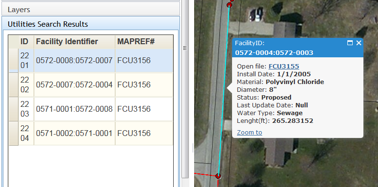

I have the code below that shows the info window on map click. I would like to call the same function in the gridRowClick event.

the image below is the final result I am trying to achieve.

RichardMoussopo
Thank you Ken for replying...
I tried what you said and it did not work. I also tried to change
identifyParams.geometry = point;   line 16 above
but still nothing.
