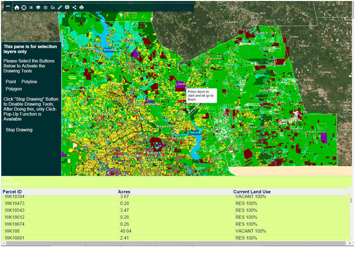

We need to customize the ESRI’s JavaScript Template as the following from ESRI's Github:
https://github.com/Esri/Viewer
I insert our own codes in two files: one is index.html and the other is main.js inside the js folder. What we want to do is to create our own draw tool in a separate pane on the left (see the image below), and control it from main.js; in addition we want to display the information in the datagrid at the bottom when users use the draw tool to select features on the map.
I put the source codes of index.html and main.js as below.  In the viewer template, these are the only two files that we made modification.  The debug of main.js always indicated that “Cannnot read property ‘graphics’ of undefined”.  I post the question as the following before but still don’t understand where the map is loaded.  https://community.esri.com/thread/113384
In main.js file, all the other codes are the same, our own customized codes are inserted all inside the addLayers: function (tool, toolbar, panelClass) {****}, this addLyers function is ESRI’s built-in function. Only this part is posted below:

            //Set up the query function *****************************************
            //Build a feature layer
            var j9t4 = new InfoTemplate("Current Land Use", "${*}");
            var sUrlQuakesLayer = "http://arcgis02.h-gac.com/ArcGIS/rest/services/Land_Use/Current_Land_Use_New/MapServer/0";
            var outFieldsQuakes = ["ParcelID", "Acres", "Current_Land_Use"];
             var lyrQuakes = new FeatureLayer(sUrlQuakesLayer, {
                id: "Current Land Use",
                outFields: outFieldsQuakes
            this.map.addLayer(lyrQuakes);
            //Set up a single draw tool as Polygon for test purpose
            var tbDraw = new Draw(this.map);
            tbDraw.activate(Draw.POLYGON);
            tbDraw.on("draw-end", displayPolygon);

            //SelectQuakes set up
            function selectQuakes(geometryInput) {
                alert("Going into selectQuakes--2"); //------------------------
                // Define symbol for selected features (using JSON syntax for improved readability!)
                var symbolSelected = new SimpleMarkerSymbol({
                    "type": "esriSMS",
                    "style": "esriSMSCircle",
                    "color": [100, 100, 100, 128],
                    "size": 6,
                    "outline":
                        "color": [255, 0, 0, 214],
                        "width": 1
                var sls = new SimpleLineSymbol({
                    "type": "esriSLS",
                    "style": "esriSLSSolid",
                    "color": [67, 0, 255, 40],
                    "width": 5
                var sfs = new SimpleFillSymbol({
                    "type": "esriSFS",
                    "style": "esriSFSSolid",
                    "color": [255, 255, 0, 200],
                    "outline": {
                        "type": "esriSLS",
                        "color": [255, 0, 0, 215],
                        "width": 2
                }); //LAST NUMBER AS A ALPHA VALUE
                lyrQuakes.setSelectionSymbol(sfs);
                 * Step: Initialize the query
                var queryQuakes = new Query();
                queryQuakes.geometry = geometryInput;
                lyrQuakes.on("selection-complete", populateGrid);
                lyrQuakes.selectFeatures(queryQuakes, FeatureLayer.SELECTION_NEW);
                registry.byId('cpBottom').selectChild(registry.byId('divGrid2'));
            } // selectQuakes () ends here
            //Create a datagrid
            var gridQuakes = new (declare([Grid, Selection]))({
                bufferRows: Infinity,
                columns: {
                    ParcelID: "Parcel ID",
                    Acres: "Acres",
                    Current_Land_Use: "Current Land Use",
            }, "divGrid2");
            //Pop up to index div compoment
            function populateGrid(results) {
                var gridData;
                dataQuakes = array.map(results.features, function (feature) {
                    var dateConvert = new Date(feature.attributes[outFieldsQuakes[2]]).toLocaleString();
                    return {
                         * Step: Reference the attribute field values
                        "ParcelID": feature.attributes[outFieldsQuakes[0]],
                        "Acres": feature.attributes[outFieldsQuakes[1]],
                        "Current_Land_Use": feature.attributes[outFieldsQuakes[2]],
                // Pass the data to the grid
                var memStore = new Memory({
                    data: dataQuakes
                gridQuakes.set("store", memStore);
            }   //populateGrid fucntion ends here

The other question is that the inserted codes in index.html seem very weird, e.g., <button id="point"…> and <button id="freehandpolyline"…>, <button id="freehandpolygon"…> do not display well.  The TabContainer with two ContenPanes as divGrid and divGrid2, does not show the two Tabs in a row.
Thanks a lot for reading this and any hint will be very helpful!

    <div id="leftPane"
         data-dojo-type="dijit/layout/ContentPane"
         data-dojo-props="region:'left', splitter:'true', gutters:false">
        <b>This pane is for seleciton layers only</b>
        <div>
            <!--<p>
        The custom operation inherits from esri/OperationBase.
        <a target="_blank" href="./myModules/customoperation.js">This is a testing hyperlink</a>.
    </p> -->
            <p>
                Please Select the Buttons Below to Activate the Drawing Tools
            </p>
        </div>
        <button id="point" data-dojo-type="dijit/form/Button">
            Point
        </button>
        <button id="freehandpolyline" data-dojo-type="dijit/form/Button">
            Polyline
        </button>
        <button id="freehandpolygon" data-dojo-type="dijit/form/Button">
            Polygon
        </button>
        <p>
            Click "Stop Drawing" Button to Disable Drawing Tools;
            <br />After Doing this, only Click-Pop-Up Function is Available
        </p>
        <button id="stop" data-dojo-type="dijit/form/Button">
            Stop Drawing
        </button>
    </div>
        <div id="cpBottom" data-dojo-type="dijit/layout/TabContainer" data-dojo-props="
    splitter:'true', region:'bottom', closable:true">
            <!--<div id="GridClose" class="GridCloseIcon" data-dojo-type="dijit/layout/ContentPane"
             title="Close Grid" onclick="closeGrid();"></div> -->
            <div id="divGrid2" data-dojo-props="title:'TAZs'" data-dojo-type="dijit/layout/ContentPane"></div>
            <div id="divGrid" data-dojo-props="title:'Land Use'" data-dojo-type="dijit/layout/ContentPane"></div>
        </div> <!-- cpBottom End -->
