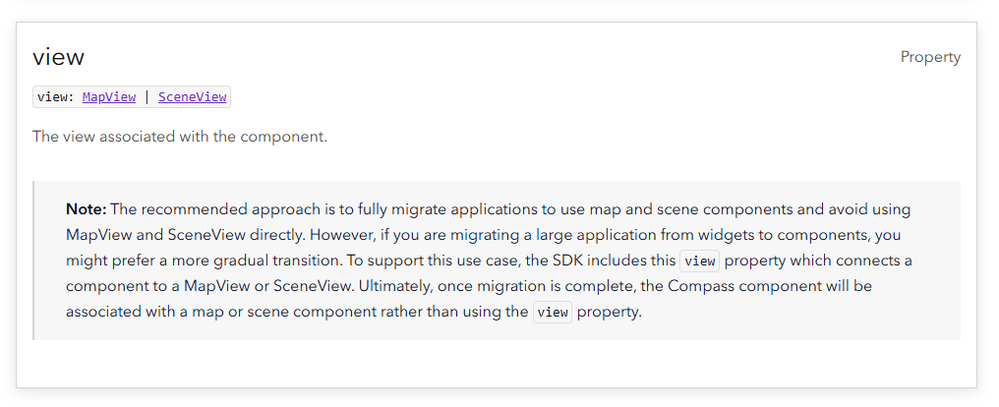

At the same time, the documentation states that this approach should be avoided:
Docs: https://developers.arcgis.com/javascript/latest/references/map-components/arcgis-compass/#methods
What is your recommended approach for migrating such components that are not direct children of the map-component?

Hi, you can use the reference-element attribute to associate the component with your map. Just set the reference-element to the map's ID and that will connect them! Here's an updated version of your codepen: https://codepen.io/annefitz/pen/PwzjgLw?editors=1001
