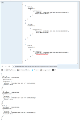

HusseinNasser2
This is useful thank you.
I was able to reproduce and I do see what is going on. HonorSequenceOfEdits controls the outside layer edits payload, not the individual edits within a layer. As you may have noticed, the array of updates within a single edit are ordered by objectId and executed in ascending order (lowest objectid first). So in your example, objectid 61818 is updated first, followed by 71416 which is made into a main address, resulting in the failure, because 71816 was not updated yet.
If you want to force the 3 updates to be in executed in the order, you will just need to change the payload from one edit with 3 updates to 3 edits each with a single update. They will still be in a single transaction, but 3 distinct edits to the same layer instead.
Here is your applyEdits (simplified) before and after the change.
//one edit, 3 updates
        "id": 21,
        "updates": [{
                "attributes": {
                    "objectid": 71816,
                    "globalid": "{0539CB83-A63B-4ED2-9502-398A414DB666}",
                    "object_address_type": 0,
                    "object_id": "{9BE6E41A-8558-4268-B6B3-FB96A755B98D}"
                "attributes": {
                    "objectid": 71416,
                    "globalid": "{528C37D9-A398-4EC2-9AB4-027754F456B3}",
                    "object_address_type": 1,
                "attributes": {
                    "objectid": 61818,
                    "globalid": "{F37ED8AD-3D2B-4B8A-BB93-9DAD47B512FC}",
Change it to
//3 edits, one update in each.
        "id": 21,
        "updates": [{
                "attributes": {
                    "objectid": 71816,
        "id": 21,
        "updates": [  {
                "attributes": {
                    "objectid": 71416,
        "id": 21,
        "updates": [  {
                "attributes": {
                    "objectid": 61818,
This payload should solve this issue.
Here is my repro case before and after the applyEdits change
after the change it works

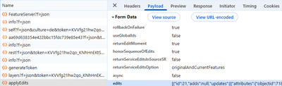

RichRuh
Hi Sebastian,
Would it be possible to post the REST request that is generated from the `featureService.applyEdits` call? (Using debug tools, fiddler, etc.).  That would let us see if the problem is occurring client or server side.
Thanks!
--Rich
SebastianKrings
here you are
edits:
"object_address_type" is the object where the attributeRule checks on.
"Herweg 3" (the first of the three) is currently being the MainAddress with "object_address_type" = 1.
During the edits you can see it is set to 0 and it is the very first in sequence before the second item is set as new MainAddress.
        "id": 21,
        "adds": null,
        "updates": [{
                "attributes": {
                    "objectid": 71816,
                    "object_address_id": "{f0f1620d-b201-47ad-8295-9f1bb089e777}",
                    "from_address_id": "{54D1EBA5-8F37-4B19-94A5-E77DB2260C8A}",
                    "to_address_id": null,
                    "thoroughfare_id": null,
                    "object_id": "{9BE6E41A-8558-4268-B6B3-FB96A755B98D}",
                    "created_user": "myuser",
                    "created_date": 1769081983000,
                    "last_edited_user": "myuser",
                    "last_edited_date": 1769081998000,
                    "relationLayerTitle": "Objekte Adressen",
                    "enhanced_from_address": "Herweg 3",
                    "enhancementLayerTitle": "AddressLayerTitle"
                "attributes": {
                    "objectid": 71416,
                    "object_address_id": "{2776a7d1-5c60-41dd-9e3b-002d2c06a45e}",
                    "from_address_id": "{EFA5BBDE-CF8C-4C24-9120-706E2EC8958D}",
                    "created_date": 1768991993000,
                    "enhanced_from_address": "An der Bundesstraße 1",
                "attributes": {
                    "objectid": 61818,
                    "object_address_id": "{30B1EA83-C497-43AD-8EA2-D00DF7C83257}",
                    "from_address_id": "{25A3F94D-F02B-4F1B-A147-D8508D086D55}",
                    "created_user": "Test",
                    "created_date": 1761214382000,
                    "enhanced_from_address": "An der Bundesstraße 2",
        "deletes": null,
        "attachments": null

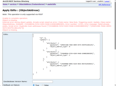

And here is the reponse referring to the attribute rule:
    "error": {
        "code": 400,
        "extendedCode": -2147207418,
        "message": "Unable to complete operation.",
        "details": [
            "Objekt fehlt.",
            "Interner Fehler während Objektaktualisierung. Attributbedingungsregel wurde verletzt. [\nRegelname: Hauptadresse prüfen,\nAuslösendes Ereignis: Aktualisieren,\nKlassenname: ObjectAddress,\nGlobalID: {528C37D9-A398-4EC2-9AB4-027754F456B3},\nFehlernummer: 23,\nFehlermeldung: Es darf nur eine Hauptadresse zu einem Objekt existieren.]",
            "Operation wurde zurückgesetzt."

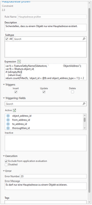

And this is the actual AttributeRule:
var fs = FeatureSetbyName($datastore, "my.domain.ObjectAddress");
var fk = $feature.object_id;
if (isEmpty(fk))
    {return true}
return count(Filter(fs, 'object_id = @fk and object_address_type = 1')) < 2
We tried to check/uncheck the parameter "Exclude from application evaluation" but that did not make any difference.

        "id": 21,
        "updates": [{
                "attributes": {
                    "objectid": 71816,
        "id": 21,
        "updates": [  {
                "attributes": {
                    "objectid": 71416,
        "id": 21,
        "updates": [  {
                "attributes": {
                    "objectid": 61818,

HusseinNasser2
Correct, you need HonorSequenceOfEdits to be set to true to respect the array order in the applyEdits. Otherwise if that parameter is false or not provided, we will use the layerId order, which in your case it will be non-deterministic since all of them are same layer
more on the doc
https://developers.arcgis.com/rest/services-reference/enterprise/apply-edits-feature-service/
