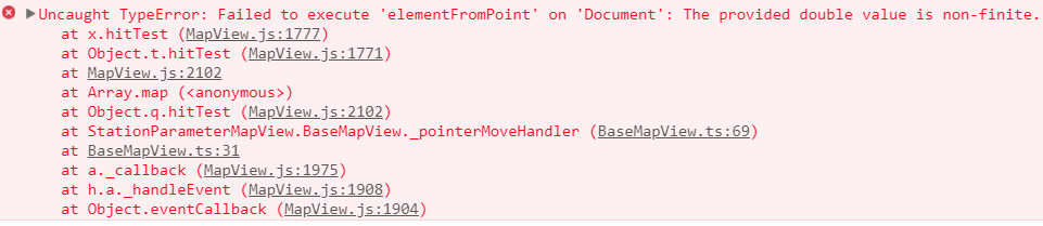

I'm using Arcgis api for javascript 4.5,  and got following issue after mouse over on the map a few times:
Here's my mouse over handler:
this.config.view.on("pointer-move", (event) => this._pointerMoveHandler(event));
_pointerMoveHandler(event: any) {
// the hitTest() checks to see if any graphics in the view
// intersect the given screen x, y coordinates
this.config.view.hitTest(event)
.then((event) => this._showGraphicTooltip(event))
.otherwise((event) => this._closeToolTipDialog());

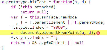

Here's MapView source code:

This apparently is a bug in hitTest that is fixed in 4.7
https://community.esri.com/message/759086-4x-hittest-issue
