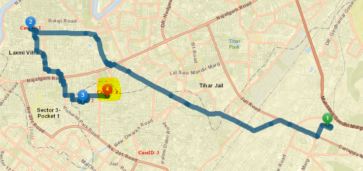

I can change the image in one of the stops as mentioned in the below screenshot
there that location 3 is having blue pin in the widget but red pin remains unchanged in the map.
it will be very much helpful for me if you could provide the area where i should make changes to get the desired blue pin on the direction showing within the map too.

RobertScheitlin__GISP
MVP Emeritus
Siva,
   For that you have to modify the Widget.js file (lines 5, 9, 31, 32 and 41). Also add this css rule with the earlier one:
.esriDMTStopDestination .esriRouteIcon {
  background-image: url(../images/bluePoint.png);

SivaramKrishnan2
Robert
Thank you so much, it is working for me.
