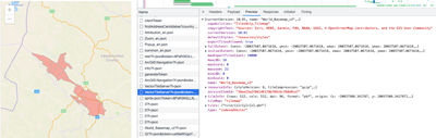

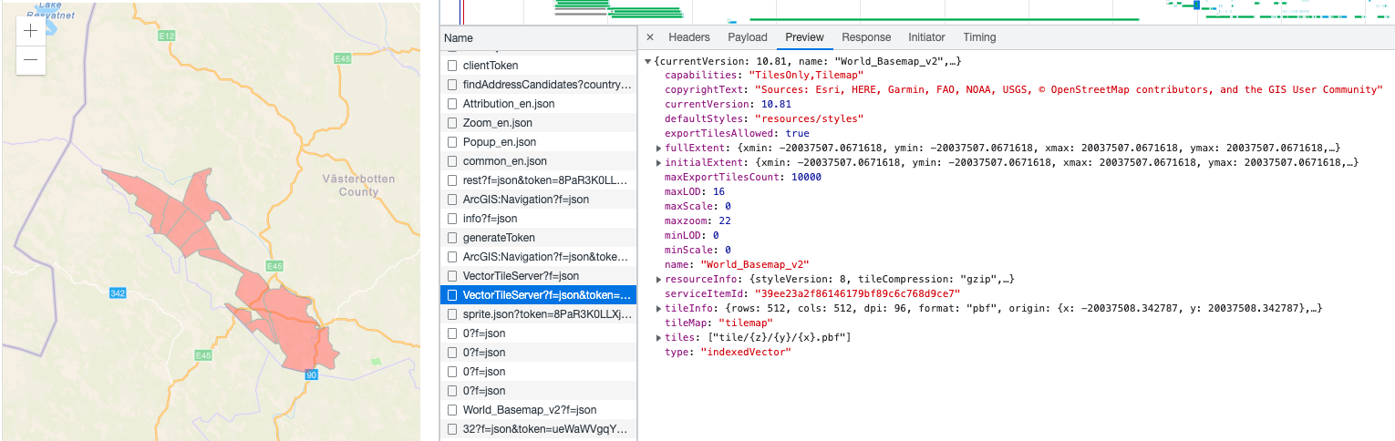

We are running this in a react component - using Create-React-App, and when running this using the development mode (react-scripts start) - unminified - it is loading perfectly fine and working really well:

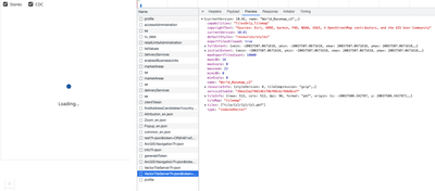

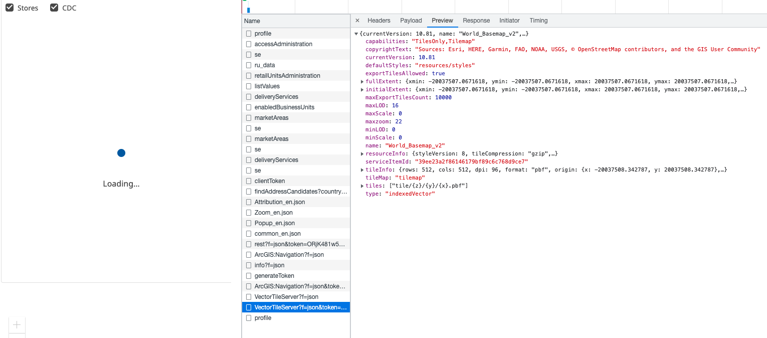

However - when create a minified build (react-scripts build) and serve it from there - it stops mid-loading after the VectorTileServer call - which seems to respond well with the same results as the unminified one. I've gone through and checked every call Arcgis makes and they all match up perfectly - the only difference is that it won't go on and load the next call. How could this be?
I wonder what could be causing this - and I would gladly take any ideas on how to troubleshoot this.

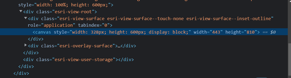

I'm experiencing something similar.  Using React 17 in dev mode the AGO webmap loads as expected.  Run build and the web map does not load at all, although I see the esri-view-root div added to the DOM.  I noticed the canvas tag, shown below in dev mode, is missing from the DOM when running the production build version of the app:
Thanks to your suggesting I updated to 4.24 and the problem seems to be resolved.
