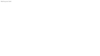

GavinRehkemper
Depending on your application and requirements (especially browser version support), using "Number.isInteger()" may be a slightly simpler way to do this:
view.when(() => {
  view.watch("zoom", (evt) => {
    if (Number.isInteger(evt)) {
      // your code here will only run on zoom-end
Full example: https://codepen.io/gavinr/pen/yLvOaod
When setting a "watch" on the zoom property of the ArcGIS API for JavaScript, you get events as the zoom is happening. This example shows that behavior...
