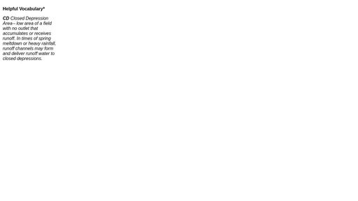

How would I recreate this expandable "infoDiv" using map components? I don't understand how to get it in the view when there is no longer a view. I'd rather not create a html/css button outside the view.
This is the html of the app I'm currently creating.

You can currently add custom content to an expand using the `arcgis-placement` component inside expand.
https://developers.arcgis.com/javascript/latest/references/map-components/arcgis-placement/
Here is your snippet updated.
